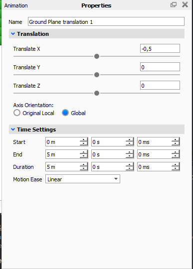

Hi, i’ve got an animation in which want to translate a groundplane.
Unfortunality the render doesn’t look smooth, when i go through the frames the groundplane only moves so many frames,
so on frame 1-12 it stays still, on frame 13 it moves, then it remains still for frames 14-26 and moves on frame 27 again.
My settings are as follows:
Hi Daniel,
Would you be able to share your scene file with us? It would greatly help investigating.
In any case, given the parameters of your animation, the ground plane will be moving extremely slowly in 27 frames, i.e. about one second if your FPS is 30. So my guess would be that at frame 13 it reaches the boundary of an object (for example the face of a cube that is perfectly parallel with the ground plane), which is why you suddenly see a change in the render.
Is that the case?
Florian
